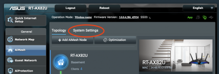

Thanks for the suggestions, everyone. I think the problem is now solved. Here are all the things I did:
* checked if "Smartconnect" is off
* factory reset the node by pressing the reset button for 15s
* In "System Settings" under Ai Mesh, enabled "Ethernet Backhaul Mode"
* readded the node in Ai Mesh
it's been more than 10 days, hope it will continue to work :)
