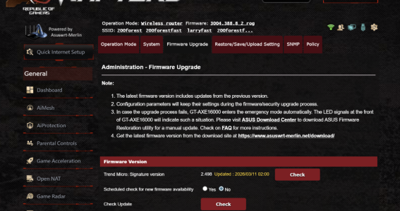

i belive based on the image below that at some point someone screwed up and posted a version 2.498 thinking it was 2.4.98 ie just before 2.5 and that screwed the pooch.. it is the same on my older gt-axe16000 still running 3004 versions .and an gt-11000 pro also running 3004
i just forced upgrade/downgrade on both so they are now on 2.50

You got the illusive "2.50"? I seem to have lost it through factory resetting...

I ran the ssh cmd then update check on a GT-AX6000 and a RT-AX88U Pro and both of those updated to 2.450; not 2.50… maybe a typo by @lgkahn?
Mine were both at 2.498 to start with.
I hear ran the ssh cmd then update check on a GT-AX6000 and a RT-AX88U Pro and both of those updated to 2.450; not 2.50… maybe a typo by @lgkahn?

Honestly I have no idea what you were seeing, however given the latest version in all the screenshots folks are posting says 2.450, on the balance of probabilities the latest is probably 2.450.
I’m not too fussed to be honest, @dave14305 trick worked as it always does, it did an update, I got the latest sig as reported.
