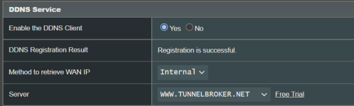

It does not work with tunnelbroker (Hurricane Electric).
Good with previous firmwares.
IPv6 DDNS support was disabled in previous firmware, so I highly doubt it was "good"...
