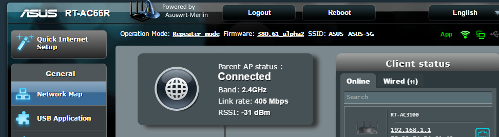

AC3100 and AC66U builds "380.61 alpha2" work without issue so far. I am using AC3100 as a Router and the AC66U as a Repeater, I like the new RSSI signal info when in repeater mode
(and the nice picture of my AC3100 in the client list).
