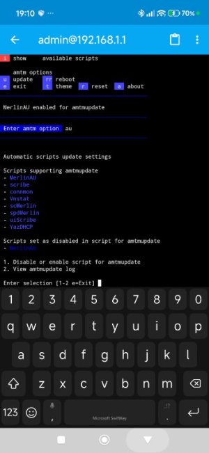

Hello I try au and disable MerlinAU if try again au I expect enabled MerlinAU but still disabled
As MerlinAU has it's own built-in script update setting I'd not worry about it. Likely the case is MerlinAU will be updated at some point to support au in amtm.
With that blur I cannot read what script has amtmupdate disabled under „Scripts set as disabled in script“.
Every script listed under that header has set it as disabled in its setting. amtm cannot run updates on any of them.
It has to be enabled in that script. Diversion has a setting in d to do that. MerlinAU may have it auto-disabled when it’s own auto update function is active.

amtm listed MerlinAU as supported in the screenshot.
Yes I updated to last version but if add to disabled there is no way remove from list by au
Which means that the auto-update function in MerlinAU is enabled. Leave it that way.
