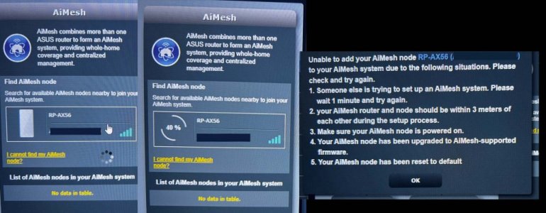

Had a major T-storm so unplugged my electronics. Plugged everything back in and noticed my camera system wasn’t online. Now there’s issues again with the ROUTER/ NODE A. Plugged NODE A right next to the ROUTER. NODE A boots up *white light” then it goes out for a second or so then it displayed a green light (connected to the router). Logged into the ROUTER under General > Network Map, in the middle/ bottom AiMesh Node: 0, on the right under ‘AiMesh’ I don’t NODE A. Held the WPS button on NODE A (blue blinking), hit the search button in the ROUTER settings under ‘AiMesh’ to see if it would discover the node, it did not, it said the following:
Unable to find any AiMesh node nearby.
a. If this device is assigned as a AiMesh router, please check the following and try again.
1. Your AiMesh node is powered on
2. Your AiMesh node has the latest firmware
3. Your AiMesh node has been reset to default
4. Move your AiMesh node close to the AiMesh router
b. If this device is assigned as a AiMesh node, please check the following and try again.
1. Push the reset button on this device and then wait.
2. Login to your AiMesh router GUI and click on the AiMesh
icon.
3. Upgrade your AiMesh router's firmware if you cannot find the AiMesh icon on the router GUI.
I then factory reset NODE A and started the same process again. This time during AiMesh search in the ROUTER software it found NODE A, GREAT! Clicked NODE A in the ROUTER software and a % from 0 - 100 started. Thinking it would of connected since it displayed that it saw NODE A, nope, I got the following:
Unable to add your AiMesh node RP-AX56 (some long alpha/num) to your AiMesh system due to the following situations. Please check and try again.
1. Someone else is trying to set up an AiMesh system. Please wait 1 minute and try again.
2. your AiMesh router and node should be within 3 meters of each other during the setup process.
3. Make sure your AiMesh node is powered on.
4. Your AiMesh node has been upgraded to AiMesh-supported firmware.
5. Your AiMesh node has been reset to default
I then tried holding down the WPS button on the ROUTER then on NODE A to see if it maybe it would connect that way. Same results, light turns green, check to see if it shows up in the ROUTER software but it’s still now showing up. Restarted my ROUTER and tried the above all over again with the same results.

I tried the above again with the new node, NODE B, I bought and hardware (1 & 2) held down the search button on NODE B (blue blinking light), hit search in the ROUTERs software, still not found. Tried holding the WPS button on the ROUTER thinking NODE B’s light would turn green, still just blinking blue, won’t connect. Then I tried saving out my prefs and factory resetting my ROUTER. After factory reset I added my profile back and tried again. Still nothing. NODE A still connects (green light) doesn’t show up in the ROUTER software, NODE B still just blinking blue. I do see however under General > Network Map, on the right under ‘Client statusNODE A in the ‘Wired’ Tab. It has an IP and everything, how can the router see NODE A there but not under 'AiMesh Node'? Why won’t NODE B connect at all but NODE A will??
One more odd thing that it does sometimes when searching for the Node in the ROUTERs software it will auto log me out of the ROUTERs software. Why would it do that??

User "jzchen" said the following (source: https://rog-forum.asus.com/t5/gamin...p-ax56-keeps-disconnecting/td-p/930168/page/6)
I checked and that is latest firmware for RT-AX89X. Please check for and update firmware for RP-AX56 and RP-AX58.
For hard reset of the nodes:
Unplug from power outlet.
Press WPS button and HOLD.
Plug into outlet keep holding WPS. It will very soon start blinking white. Keep holding WPS button until it stops then it will start blinking alternating white/yellow (not sure these colors but it will blink again). Unplug and release WPS. Plug back in.
Use AiMesh search function on RT-AX89X to find node.
(You should be able to do all this while Ethernet cable is connected between LAN port and port on RP. Hopefully it can find it with Ethernet outlet image).
I first tried with NODE A, Press and held the WPS on NODE A, pugged it in still holding the WPS button. The yellow/white blinking combo DOES NOT happen. It would slowly pulse white then blinking green back to pulsing white, then nothing (like it was off) for a second, and repeats the same patter again and again. I then unplugged NODE A, no longer holding the WPS button, plugged back in. Booted up (white light) then it moved onto blinking blue (pair mode). I first tried to connect via the ROUTER's UI, hit the ‘search’ button then pressed/held the WPS button on NODE A. NODE A starts blinking blue, sees the ‘RP-AX56’. Click it and connect to it. Then there’s a %, waiting for it to connect, for some reason it logs me out of the ASUS ROUTER UI, NODE A reboots. I log back in and now it’s at 40% and still waiting to connect. At about 65% it fails to connect (added a screenshot). I then try and connect via ROUTER’s WPS, pressed/held button, then moved onto NODE A WPS button, pressed/held. After a few seconds it connects, NODE A light is green. Refresh ROUTER’s UI, AiMesh Node is still 0, not connected to the node. Sign…
Next is NODE B, Press and held the WPS on NODE B, plugged it in still holding the WPS button. The yellow/white blinking combo DOES happen (doesn’t with the AX1800 (RP-AX56)). I then unplugged NODE B, no longer holding the WPS button, plugged back in. Boots up (white pulsing light) then a solid blue light. I hit the ‘search’ button in the ROUTER’s UI, press/held the WPS button on NODE B till the blinking blue light appeared and waited for it to show up in search. After a few seconds NODE B light turned a solid white and I again was logged out of the ROUTER’s UI. After logging back in it still doesn’t show up. Last step I tried was to unplug NODE B, plug it back in to reboot (white pulsing light) and then blinking blue light (pair mode). I pressed/held the WPS button on the ROUTER waiting to see if NODE B would pair. All of a sudden NODE B light turns solid white, it auto logs me out of the ROUTER’s UI and does nothing like it locked up. I can't even get NODE B to connect at all (green light) like I can NODE A, even though it doesn't show up in the ROUTER with that green light. Back at square one. Am I alone with this issue?
