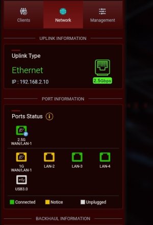

Asus GT-BE98, WAN Notificatians

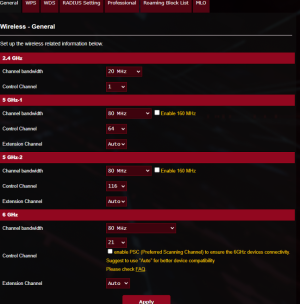

Set the 2,4 GHz to channel width of 20 MHz, set to a specific channel, WPA, etc for best chance of keeping them online. If some are really marginal RSSI ( look in logs and do survey), you may have to add an AP.

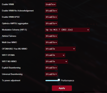

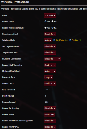

Attaced are my settings. let me know if I should change anything. Ive researched and tried but im a novice at best
