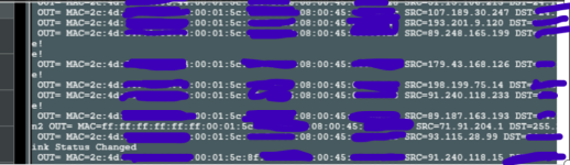

I've attached a screenshot of what the Three Mac Addresses on my Asus Router Syslogs is happening. This is similar or the same of what should have uploaded in the first place. Also there is a Public IP Addresses that is not my Public IP Address is accessing a Broadcasting DST. 255.255.255.255 I do not have anything configured on my router to to be doing this. There are quite a few of these Public IP Addresses and I was wondering what is happening.

You've redacted or obscured so much of the information it's difficult to guess what you're talking about.
What 3 MAC addresses? You've obscured all the MAC addresses. Do you mean IP addresses? If so, that is normal port scanning from the internet.
That is broadcast traffic on your ISP's local network, probably from their DHCP server.

What is happening is that you've taken a packet capture, aren't understanding what you're seeing and are freaking out about it unnecessarily.
OK. I've finally worked out what you were trying to say. This would have been so much easier if you hadn't redacted so much information.
There are not three MAC addresses there are two.
The first MAC address 2c:4d:xx:xx:xx is your router's WAN interface.
The second MAC address 00:01:5c:xx:xx:xx is your cable modem.
08:00 is the EtherType for IPv4.
45:xx:xx:xx is beginning of the payload data. ***
