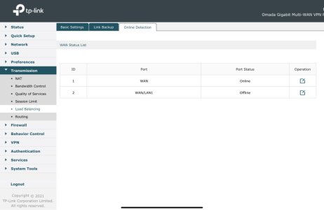

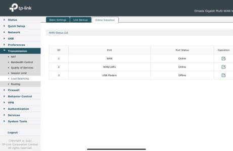

As you can see in this photo, it shows my secondary link offline when in fact, I can still access my fiber modem as well as the Plex server directly connected to that modem from behind my AX86U_Pro.

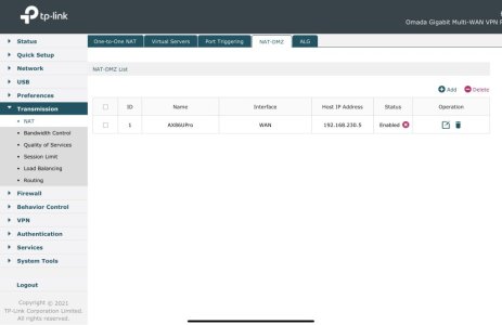

If you can not place your ISP device in Bridge or Pass Through mode, then place the ER605 in a DMZ on the ISP device. This is what I have to do.
Then on the ER605, place your Asus in a DMZ. I know, triple NAT but it has been working great for me without any issues.

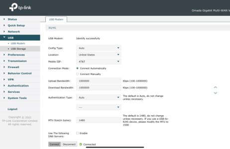

I was running a USB Modem as a third failover but changed wireless carriers and have not yet gotten another USB modem from the new carrier.
Got my new USB modem in and online with the ER605 !!

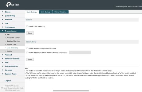

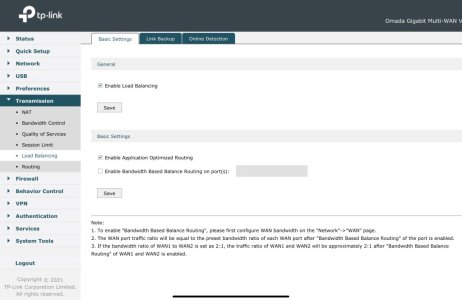

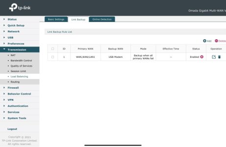

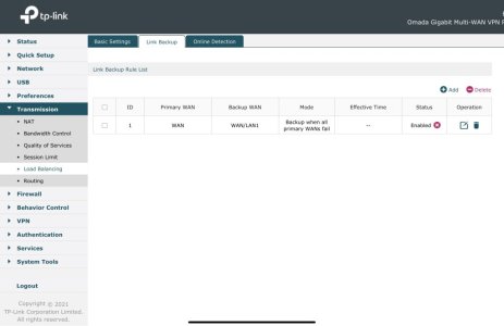

The Load Balance setting is a little confusing.
If you are running Dual WAN then enable Load Balancing regardless of any other settings.
The settings in the Link Backup tab will actually determine how the WAN links are used.
In your case:
your Primary WAN interface would be: WAN
your Backup WAN interface would be: USB Modem
The MODE would be: Backup when all primary WANs fail
NOTE: In my case, I use both WAN and WAN/LAN as Primary since I have 3 WAN connections.
The
  • Enable Application Optimized Routing
settings allow using Load Balancing on my two WAN ports without causing issues using secure online services like banking.
It is amazing how far superior the ER605 handles all this versus an Asus router.
