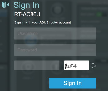

This is something new:
I have also had that screen appear on more than one occasion. I am using google chrome latest version. Closing the tab down and opening a new login again and it gone. And just as I am typing this the auto logout kicks in and this...
