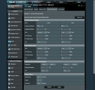

My first teori was poor wifi connection, but it seems to be the same if the units have -35 or -75 dbm. Changing limit to -85 result still same problem. Then I checked off something I find wrong, the smart connect rule as I found noe actual rule. But still same problem.

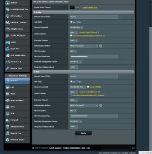

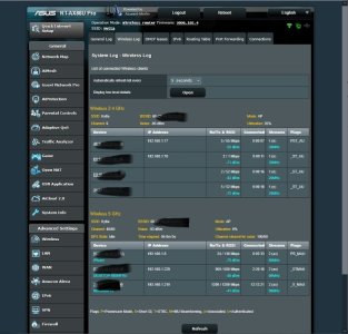

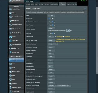

I enclose pictures I hope can do it easier to suggest a solution. Anyhow there is something in the config that restart wifi connection with fixed ip devices every 5-15 seconds. How to fix?

First try disabling “802.11ax / WiFi 6 mode” on 2.4GHz band. Then reduce Channel Bandwidth from 20/40 to just 20.

Did the first part - disabling 802.11 and it seems to work, but I must test for a while before I can tell success.

Fixing the channel also helps (instead of Auto). Disable Roaming Assistant (-70dBm). You have clients with weak below -70dBm signal and one with very weak -82dBm.

Yes, some are 20 m through a thick isolated wall and through a terracce floor and last through a leca brick wall. But the old AC router had no problem with same setup (20, 40). My experience is that the AX router work much different on wifi and that's expected. Now I use -85 dBm and can change to max -90 if it fails again.

But the other client is definitely not a range issue, it’s in a room across the hallway and practically line of sight. I tried changing the channel to static (went with 11 because there’s nothing close by in that range) and turned off the AX on 2.4, it’s reconnected without having to reboot anything this time.

Why you even have Roaming Assistant enabled on a single AIO router? Where your devices are expected to roam?
Good queston. I don't know why, but I remember using suggested setup on several forums with my old AC router. What is the adventage with Roaming Assistant? And what can be a problem without it?

In my case there was several units near by the router and also they got lost. Anyhow, now I fixed the problem doing what Dave14205 said.
