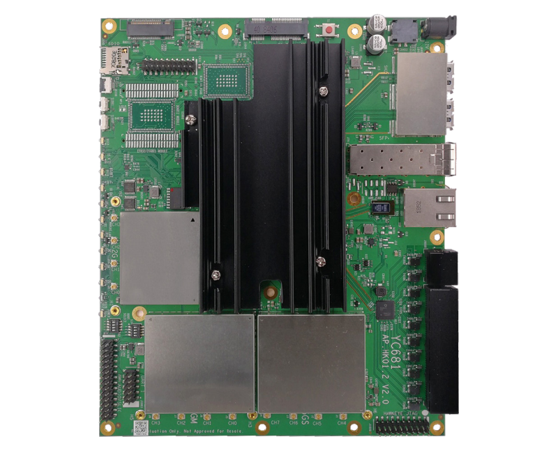

I think asus is using qualcomm reference hawkeye platform, as i seen it has x2 10G USXGMII interfaces, so RJ45 should work
