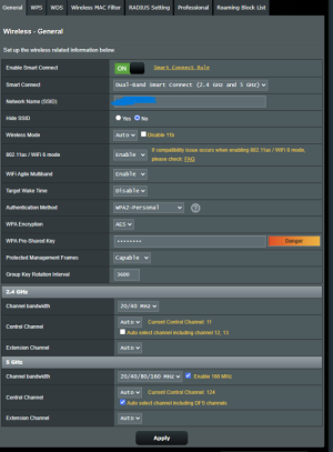

I bought a modern Asus router (dx6) with last update. What could be the problem that Smart Connect doesn't switch from 2.4 to 5 GHz? My phone supports it, and with a router from another brand with mix-connect, it works fine.

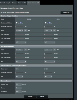

I am attaching screenshoot the Smart Connect rules and settings, they are all default. I have checked all devices in the signal quality program and physically brought them close to the router. So, based on the Smart Connect triggers, they should switch to 5 GHz, but it's not happening.
What could be the problem?

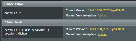

Looks like your router is an XD6? Current firmware is 3.0.0.4.388_23773
The switch may take some time or may not happen at all if the router and client are happy with the connection. Many say Dualband SmartConnect does not work and other bad comments. I do use it but set my WIFI to fixed channels and bandwidth. Yes, I can use 160 MHz bandwidth but my clients work just fine at 80 MHz on 5 GHz and 20 MHz on 2.4 GHz. It works for me!
yes both 3.0.0.4.388_23773-gad68d0f
  1. Check that the 5 GHz radio module is turned on. (Wireless, Professional, Band = 5 GHz, Enable radio = Yes).
  2. Try turning off the 2.4GHz radio module. (Wireless, Professional, Band = 2.4GHz, Enable radio = No)
If the phone can connect to a 5 Ghz radio module, the problem is in the Smart connect settings, which do not allow you to switch from 2.4Ghz to 5 Ghz.
If the phone cannot connect to the 5 Ghz radio module, the problem is in the router or in the phone.
