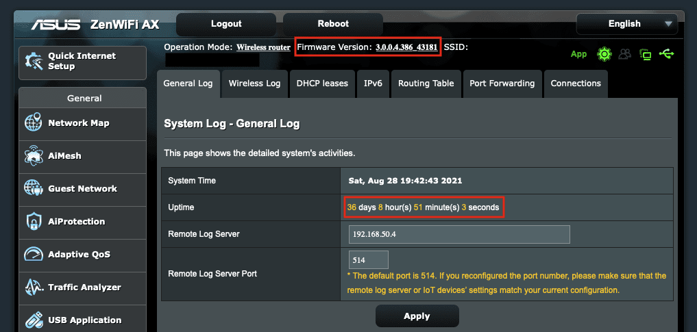

This revision has been really stable for me so far. It has 33 days of uptime and counting, and all functions are normal. I have 4 XT8 nodes, a mounted HDD for Time Machine backup.
Sorry, which revision?
As the title suggests, 3.0.0.4.386.43181
1RHAn3+

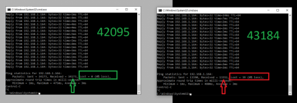

It looks good, 5GHz-2? For me, 5GHz-2 connects, but it also maintains a 2.4GHz connection with the 43184 software, but at 42095 it only keeps 5GHz-2. Unfortunately, at 43184 I am losing it.
Those are both negligible packet loss.
True, but on the old software it doesn't lose, and on the new one it does.
