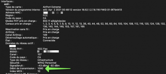

So I'm trying to optimize my wifi settings on this device to get the best performance (speed/stability) for my macbook m1. right now I get about 750mbps down / 550mbps up doing speedtest.net. I'm not sure if I could get more based on the spec mentionned on Apple website ? they mention 2/MIMO... Would it be faster if I enable AX only / 160Mhz channel ? I have a 1.5gbps isp connection here. (I didn't want to fork this thread....I just can't get more then 1080 transmission rate whatever I'm trying...) And I tried to put ax only but I still dont have the choice to put the 160mhz on the second 5ghz band :(
The M1 Macbooks do not support 160Mhz channels. The 2x2 MIMO in there can give you a max sync rate of 1200Mbps. Getting 50 to 70 percent of that is a good real world result for Wi-Fi.
