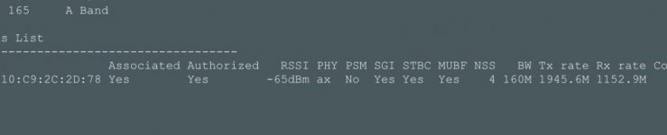

I have a pair of Netgear PLA 1200 that connect my living room to my remote outside office. I only use them when I need a network connection for remote admin ( in case I loose wifi connectivity ) into one of my routers in the living room from my desktop in the office. Other than that, they are pretty useless for any real bandwidth. My AX wifi backhaul is pretty good considering the “barriers” between the 2 XT8 units.

Wondering how big your place is? How far apart are the ZenWiFi nodes? Mine are about 40' apart, and their connection, according the the mesh firmware is "Great" *smile*. Of course, has to do with type of construction, walls, and floors as well.
