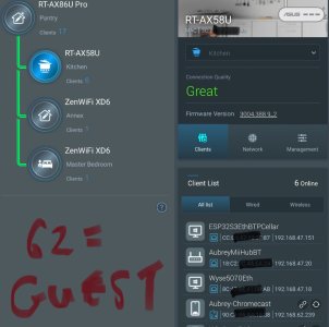

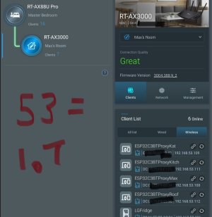

But can you confirm you've got/had nodes running 3004-firmware, a main router with 3006 running GNP, and the wireless clients connecting to the nodes can properly get tagged with a GNP VLAN ID other than 1?
I can confirm this works. Two separate setups.
Whilst I use dnsmasq-x.conf.add to assign IP addresses (and this is no different to the same 32# device option in the GNP setup screen), IIRC, whe. I first set it up (pre dnsmasq) they also got IP addresses in the correct subnet associated with the SSID/PWD.
I remain puzzled that the earlier poster is not seeing them on the correct subnet.

I'm puzzled as well, but the giant mess this is all turning out to be leaves me unsurprised.
There is significant configuration necessary in order for this to all work. Earlier poster is most likely missing a step.
