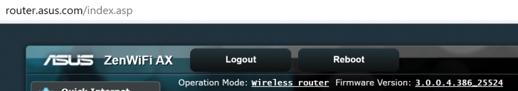

I can confirm that doesn't happen for me. I assuming you are on latest firmware. Mine is below.
That's weird, if not a DFS channel, maybe a bad unit. Try factory reset, else return/exchange.
Correct, I also use the 25524 fw. also tried the RC2 and all the way back to the first official release... but its maybe like you say.. a bad unit.
