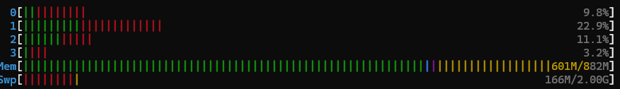

this state is pretty ok.
for real mem consumtion use htop:
in my case really used memory is 601M rest are disk buffers ...
