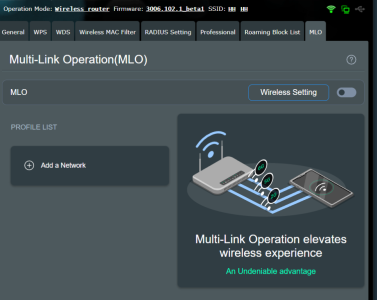

It is directly on the router and MLO has been disabled.View attachment 59354View attachment 59355

How is your MLO configured? Is it set to share the same subnet as the main network? You are hiding almost everything, so I can't tell anything out of that screenshot.
I will need to see your and @GHammer 's Guest Network configuration, as I am unable to reproduce the issue here, and I can't test MLO specifically as I don't have any Wifi 7 client.
My MLO is configured via the Wireless > MLO tab. I created an MLO ssid (different name than my primary ssid) with "Access Intranet" selected. Shares same subnet. Only change is selecting "Access Intranet", everything else is default.
