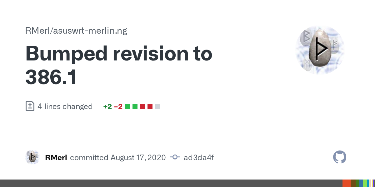

Thank yousome bits of code from 385 were just 384 repackaged with the name 385.... the only code branch that is truely different is 386. 384 and 385 share same fixes with just different names on the package. @RMerlin decided against changing the name on his package since the code bases virtually identical. However he is changing for 386 because the branch code is changing.
"edit"
For those who are curious just follow RMerlins github commits.
Bumped revision to 386.1 · RMerl/asuswrt-merlin.ng@ad3da4f
Third party firmware for Asus routers (newer codebase) - Bumped revision to 386.1 · RMerl/asuswrt-merlin.ng@ad3da4fgithub.com
I have "YET" to see @RMerlin not include a security fix once it has become available to him. Naming is just naming.
