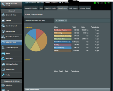

upload stats is still broken on 388.2_2 on AX86U. 2.5G is set for wan and yes I've already rebooted multiple times.
Can you post the output of:
tc qdisc show root | grep htb
cat /sys/module/tdts_udb/parameters/dev_wan
cat /sys/module/tdts_udb/parameters/qos_wan
Is your WAN connection PPP/PPPoE?
qdisc htb 1: dev eth0 root refcnt 2 r2q 10 default 0 direct_packets_stat 0 direct_qlen 1000
qdisc htb 1: dev br0 root refcnt 2 r2q 10 default 0 direct_packets_stat 0 direct_qlen 2
ppp0,eth0,wgc1,wgc2,wgc3,wgc4,wgc5
eth0
this is PPPoE FTTH.
eth0
this is PPPoE FTTH.
OK, so Merlin’s fix for one issue has created a new issue.
