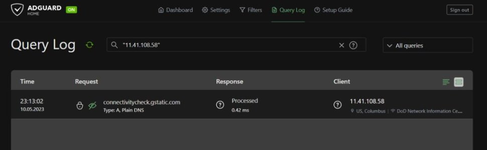

There is only one port open in my firewall - one port forwarded to port 9 to wake on WAN my NAS. I have one VPN server and two VPN clients on my router, but their private ip adresses start at 10. Queris come from the ip 11.41.108.58, which is external. I did not connect to my home network through the VPN site, and this is not possible on my configuration. I also think it has to do with the wifi connection of my samsung phone. But the IP address is strange. This IP cannot be the external IP of my phone, because it is not in the range of the IP of my mobile operator. The external ip address of my vpn site is completely different. Previously, I also had requests from extraneous IPs, but they started from 10, although they also had nothing to do with the IPs of my vpn clients and vpn servers. After their appearance, just in case, I changed the administrator password of the router, and all precautions were taken to prevent access to my router from the Internet, I never even opened port 53. I have noticed that such queris often appear when I leave the house and the phone loses home Wi-Fi, but they also appear when I am at home and my phone is connected to Wi-Fi. During this night, the number of requests from IP 11.41.108.58 has already become 28. Maybe this is also due to the instability of Wi-Fi. On my RT-AX86U firmware Merlin 388.2_2.

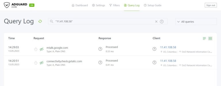

Yesterday I cleared the AGH statistics. From the moment of ban IP 11.41.108.58 until today, there were no queris from him. But today the requests appeared again. The first one was when I came home and turned on the Wi-Fi on my phone, the second after 8 minutes, and there are still no more. This is despite the fact that this IP is banned in Skynet.
P.S.: I began to suspect that the Adguard application on my phone was somehow to blame, constantly running in the background to filter ads. I'll try turning it off for a week and see.

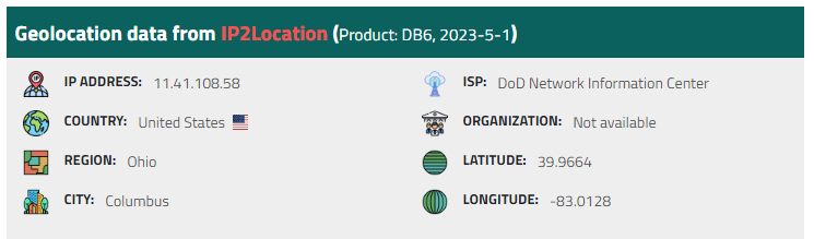

Not sure if you ran an IP lookup, but 11.41.108.58 is part of the DoD... or Department of Defense... well, that's worrysome. :(
