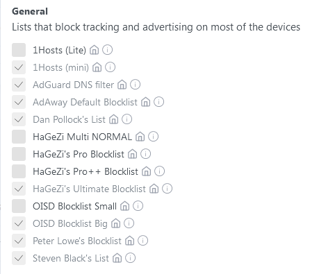

Within AdguardHome, would you know what would be a similar list to the Diversion predefined 'minimal' list? Thanks for your input!

Do you think these lists can be managed by my Ac86U?
At moment i'm using OsidBig and the 2 of Adguard.
I am not 100 percent positive, but am fairly certain you should be able to use some of them. My routers been purring along with the ones I show selected above.
I strictly use the ones supplied by AdGuard as a minimalist approach.

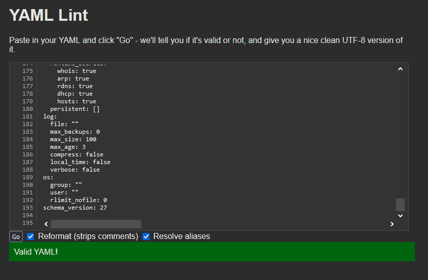

Running this command on current .yaml shows "no error" - running it on the error file is senseless as there is obviously an error in that file?
Pushing the update through amtm shows this same BS.
Info: Checking AdGuardHome configuration...
2023/12/14 18:03:06 [error] Couldn't get logging settings from the configuration: yaml: line 5: mapping values are not allowe
ed in this context
Info: Moving invalid configuration file to /opt/etc/AdGuardHome/AdGuardHome.yaml.err.
As I said earlier in the thread: this bug is new (past 2 updates) and seems to be part of the updating script, not AG home itself. I let AG make a new config file and answer all the questions yet this bug that the config file is "wrong" persists through updates. Explain how that makes sense?

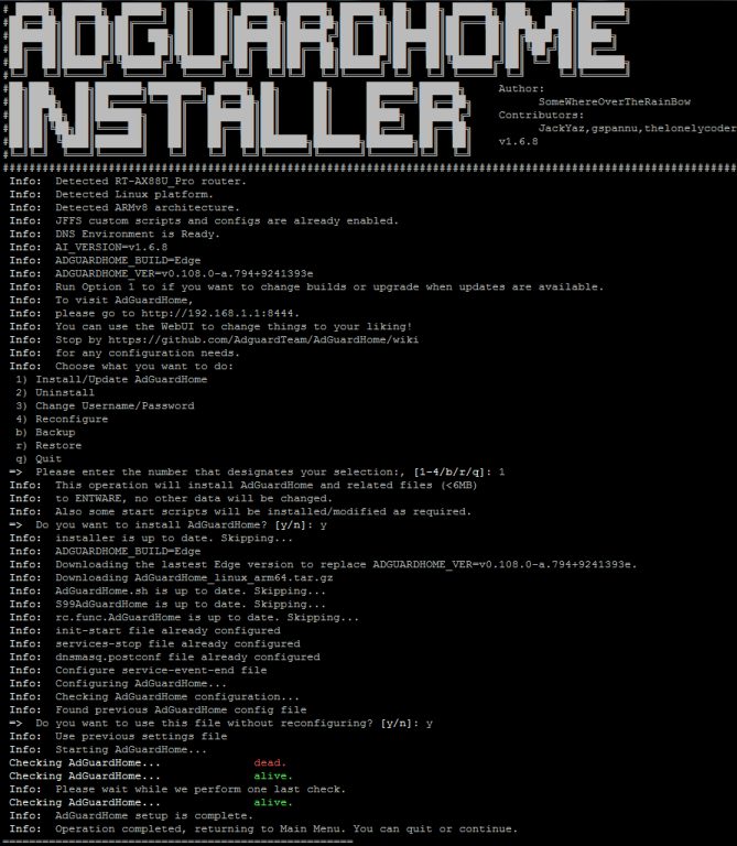

Here is "the only way" to update/upgrade using this script. Let me know if the technique, or method shown in the image below is "complicated" or "complex". I sometimes find it difficult to follow the prompts. I found myself the other day trying to use the option "3) Change Username/Password" to reconfigure the block lists and for some reason I thought the "4) reconfigure" allowed me to change the password.
Ok, thanks for what seemed like a snarky reply, that wasn't really what I was looking for.
I know option 1 should do the update, but there seemed to be a few posts roughly a week ago (around Friday, Dec 8th) that indicated they had issues as well with the update, and they implied that they had found a workaround, but perhaps what they were trying to say was that they used the same rollback (from a backup) facility that I ultimately used.
I'll just leave well enough alone for now, I don't really have a strong reason, or "need" to update anyway. It does seem to be a long standing issue with the AGH developers to continually tinker with the .yaml file configuration, not sure of the reasons behind that, but it does seem to cause trouble for user updates.
