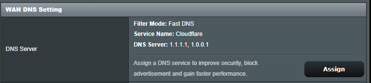

Here is the current WAN DNS settings in the Router GUI. I'm not sure if these should be changed? Possibly pointing the router to use AGH as the DNS server?

Here is the official adguardhome+Unbound guide.
https://www.snbforums.com/threads/r...dguardhome-installer-amaghi.76506/post-733236
Follow it, and you should be fine. Don't change anything in the official asus webui. Leave that part alone.

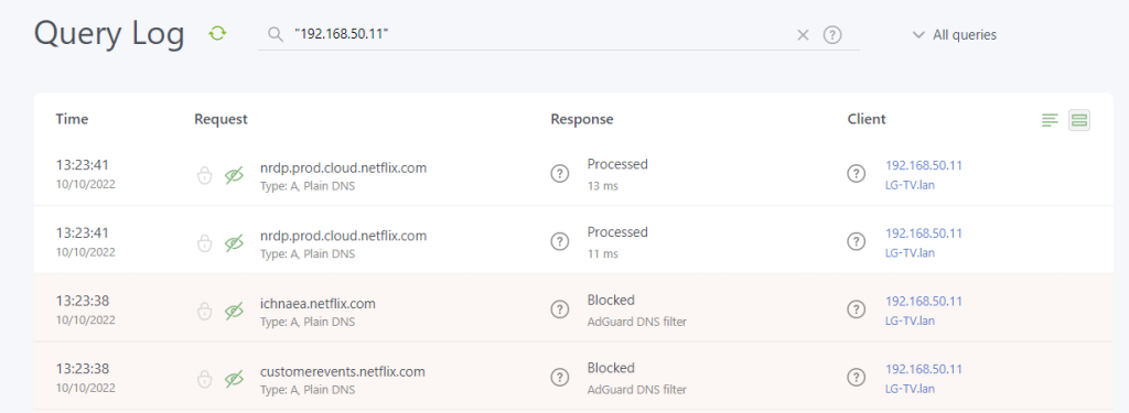

If DoT or DoH were working properly, would these queries in the Query log still show up as "Plain DNS" ?

Click on the individual query and a window will pop up telling you which server was used to respond. That (Plain DNS) is talking about the type of query which was an "A" type query.
