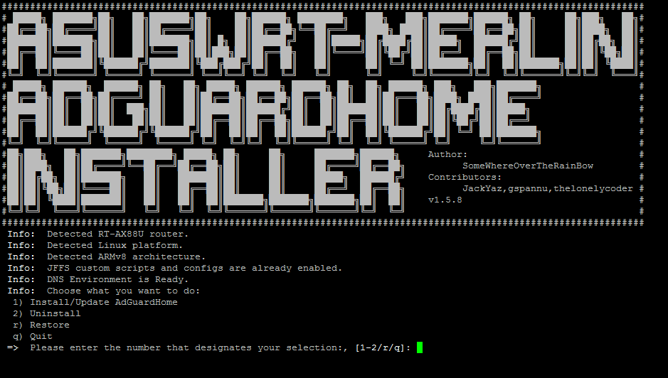

Have been running AdGuardHome for a few months and over the weekend it crashed. Started troubleshooting today and getting a strange error "...UUUU: File name too long" when starting the service. System log didn't provide any insight. Thought it was related to a corrupted file so I stopped the service uninstall and tried reinstalling but I am still getting the same error. Installing via amtm and curl result in the same issue. Anyone have any suggestions greatly appreciated. Please advise if any further details required. Thanks
Router: AX86u
Merlin: 386.7_2
Here is what my terminal looks like on the RT-AX88U.
This is with firmware 388.1 Merlin.

First time I have seen this myself. On a fresh terminal, what output do you get echo $PATH
I don't like to ask for help unless I have put in some work. So I feel better now knowing that you haven't seen this issue.
Output: /bin:/usr/bin:/sbin:/usr/sbin:/home/admin:/mmc/sbin:/mmc/bin:/mmc/usr/sbin:/mmc/usr/bin:/opt/sbin:/opt/bin:/opt/usr/sbin:/opt/usr/bin
Thanks BTW for your nice implementation of AdGuardHome.
From what I can tell, my output is slightly different than yours so, but that might not have anything to do with is since I have not seen the issue with either local or entware binaries.
I see the same for a split second (top half anyway) and than spams it "...UUU..."
This issue you are seeing could also be a SSH Terminal bug. I am honestly not 100 percent sure. You could try using a different SSH terminal and see if that is the problem.
Hopefully someone has some knowledge on what could be producing the output. Otherwise it even could possibly be as you said something corrupt.
Not a terminal issue as I just tried it with another terminal. I believe the issue is happening on the detection section of your script. As data is being populated a variable is being set with a value that is too large. Hence the file name too long. Is there a log in the install and uninstall process?
Yea I am not sure what variable is too large, but I am running it just fine on the RTAX88U with no variable issues. And other users run it just fine on other model routers running asuswrt merlin firmware. It is hard to say what could be the cause. It actually sounds like there may be an issue with the firmware specific to that router. That doesn't sound normal at all. I imagine on earlier firmware versions you were not having this issue correct? I remember you mentioning you just started having these problems.
Router: AX86u
Merlin: 386.7_2
Here are some troubleshooting steps:
Try passing the sh -x argument when running the installer. It is possible NVRAM is corrupt or hanging.
Maybe the USB storage (or Entware) you are using has gone corrupt. You could try installing with a new USB storage.
Maybe you are experiencing side effects or "bugs" that were not previously noticed in your current firmware version.
Maybe your router is running out of memory in your NVRAM or JFFS (you would need to do a factory reset and purge your NVRAM).
All of these issues are external causes which could be producing undesired consequencies for which I cannot determine myself since I am not experiencing this concern. You would have to conduct an Audit of your setup. Determine no external factor are the cause, and then I will try to troubleshoot on my end. As of right now I am chasing an issue I cannot reproduce myself.
Also, if you are using amtm to access the installer , you could try using the terminal download command instead. (This is incase you have a bady copy of the installer or are having issues with amtm.)
curl -L -s -k -O https://raw.githubusercontent.com/jumpsmm7/Asuswrt-Merlin-AdGuardHome-Installer/master/installer && sh installer

Nuked and Paved the USB. Everything is working again. I don't have allot of addons so it was easy in my case.
