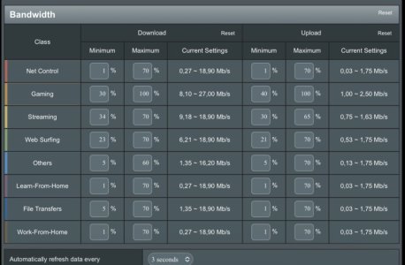

I'm a gamer and i had your same bufferbloat's problems with my previous connection. I can only say that CakeQoS is not good for gaming lag spykes, it's better to configure FlexQos giving right settings. First you have to delete any device in game mode, then in Flex customizazion Iptable rules set Xbox and Smart TV IP's as gaming devices (no ports needed) and also you have to setup correct limitations in category in Bandwidth table (i'll post here mine previous table). Then, try to setup the correct WAN packet overhead (ask your ISP) and give a try both fq_codel and Asus scripts (use cable to your Xbox or Smart Tv and try to play online, don't use bufferbloat testers online as we are focusing only on gaming devices). Also for ping lag spykes is good to setup the correct MTU (ask your ISP) and best DNS service on your console/TV. There's no "best setting" for FlexQoS but give it a try and "play" with these.
PS: check in FlexQos Menù download/upload list if you're devices are always identified as gaming devices, if not there's still problems with plain AdaptiveQoS from Asus on your router.

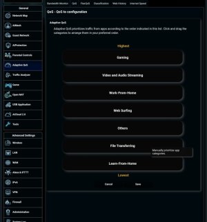

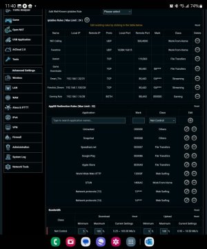

Post some pics of your FlexQoS setup. Also, ensure the "Learn‐from‐Category" is a the bottom of the list similar to my setup. My setup example is attached with STUN traffic moved to W-f-H.

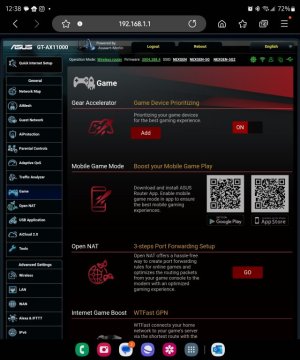

Also remove any devices if any under Gear acceletor. It should only show as "On" and nothing below it.
