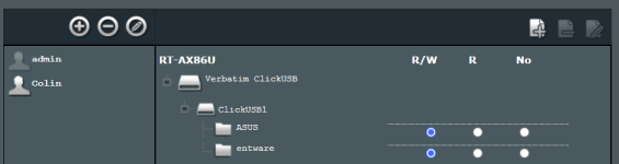

No, I'm talking about the user accounts and permissions you created on the router when you setup the shared folders.
USB Application - Servers Center - Network Place (Samba) Share / Cloud Disk
Oh wow thanks for the picture. When I am in that section of the router it won't let me click on any of the circles under R/W R or No.
Ah, that might be because you have "Allow guest login" (at the top of that page) set to Yes and therefore (theoretically) all users should have R/W access.
Can you post a screen shot of your settings?
I do indeed have Allow guest login checked. When I uncheck it the R/W column is all green dots.
