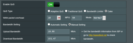

Not sure whether this has to do with the release of 386.2 beta 1 or that I misconfigured something in AutoBW in SpdMerlin. First of all, I have QoS Cake activated. I haven't really used QoS before, but read about Cake and decided to give it a try. I just noticed that since I installed 386.2 beta 1 (roughly 24 hours ago) and activated Cake QoS my bandwith is gradually being lowered over the past 24 hours. The only thing I've changed is I edited the thresholds in SpdMerlin for updating bandwith for QoS from 10% to 5%. For reference I have a 250/25 Cable (DOCSIS 3.0) connection which has always been within reasonable limits of what I'm paying for.

Auto adjusted BW values currently:
Screenshot_2021-03-11 ASUS Wireless Router RT-AC86U - EZQoS Bandwidth Management 1.png
When manually editing these back to 23.5 Upload and 237.5 Download (=95% of 25/250Mbit) I get 'normal' speeds again. It's peak hour here, so 17.41/192.40 is acceptable at this time of day.
Can someone please help me? Because if this continues I'll probably have to get my good old 56K6 modem out of the storage unit by sunrise to be faster. What should I do? I ran speedtest so it isn't in my connection and manually edited the values in QoS Settings. Should I disable AutoBW? Or is this something interacting between SpdMerlin and 386.2 beta 1?

Okay, I manually restored upstream (23.5 Mb/s) and downstream (237.5 Mb/s) in QoS settings, disabled AutoBW and the situation has returned to, more or less, normal.

doesn't get taken into account, as my speedtest gets capped at the values mentioned above. You can see the difference in the graph, prior to installing 386.2 beta 1 (250 Mb/s max downstream, QoS disabled), the sliding scale downwards (386.2 beta 1) with AutoBW calculation enabled and the situation as of last night, with manual values (see above) restored, AutoBW disable, but now my speedtest get capped by QoS, I assume?
