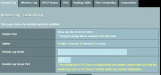

324MB free RAM is not close to crashing the router. :)
Are you leaving the GUI open? Or are you just spot-checking it?

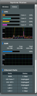

No, this is normal and efficient router operation and memory usage. Here is my example work and uptime. No problem...

I don't know how many devices you are running or how your network is set up however that is not normal for me. On top of that my web UI crashed with me unable to log on before and some devices get disconnected. This morning after the crash I decided to reupload the firmware and it seem to have fixed it for now. I will report back with crashed Web UI if it happens again. That said below is my normal operating stats after a few hours. side note: anyone know what this is?
