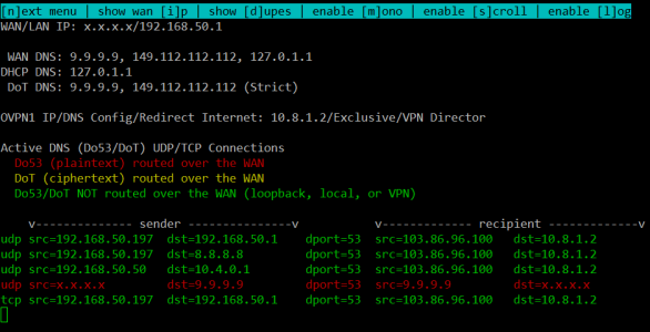

According to DNSMON, dns lookups are being routed out and back over the VPN:

According to dnscheck.tools, my DNS resolver is an exit in relation to my VPN exit point, and no longer showing my WAN IP as the resolver:

First... using the DNSMON tool (linked in the [OP]... if you see that the sender SRC and recipient DST match your VPN IP (in my case, 10.8.3.4), then you are sending/receiving over your active VPN connection. Remember... green is good! :)
Second, taking at look at the https://dnscheck.tools/ site... if you see your public VPN IP/exit and DNS resolvers are the same IP, then your VPN IP is effectively acting as your DNS resolver:
You can get even more detail running tcpdumps... but these 2 indicators above are a good sign things are working!
