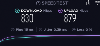

900/200 on AX86U, swapped back to AC3100 and I get 830/870. go figure.. course, my password for the AC3100 got lost in the shuffle, and I cant find a recent backup to erase/restore, so thats fun too :(

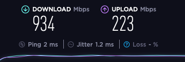

Another observation, I reset up my AX and connected via LAN I got 850/790 to Cloudflare after first booting. a few minutes later, retested, and I got 830/175. its like it take a few minutes and then the QOS kicks in or something.

It might make sense, but I don't know if I've noticed this before with the AC86U or AC68U. It seems that being logged into the router's GUI impacts speedtests.
slvrscoobie: Does fast.com (increase connections to 16 and minimum time to 10secs in settings) or nperf perform any better?
maybe? Fast reports over 1gbps, but 1/2 that speed on upload. I did do another factory reset (with merlin installed) and then disabled the QOS again. seems better. There is one server on Speedtest im getting good results from 800/800+
What server on Speedtest gave you better results? If you don't mind answering, where are you located (State)?
So, it it speedtest related issue only or actual throughput issue? If the router does Gigabit up/down the speedtest numbers are irrelevant.
How do I know I get Gigabit up/down? Verizon's speedtest reports 954/955...but can that be trusted? If I bypass the router and plug directly into my PC, Ookla's speedtest works fine again. Fast.com and nperf both give ok numbers 900/700, but all the speed test sites used to perform similarly.
