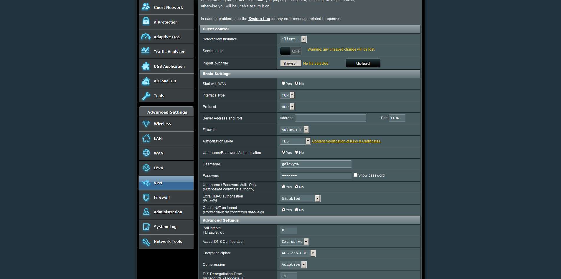

I have only one device going through the VPN, set as follows:
I have ac68u router but can not find this settings?

Using the “Policy rules” option allows you to specify which devices connect to the Internet through VPN, and which devices connect directly.

For outbound VPN connections e.g. Selective routing for say USA Netflix on VPN Client 1 and perhaps UK VPN Client 2 to watch BBC if you are outside the UK etc. ;)
