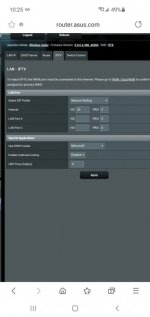

Hi, I'm from Argentina and I've Movistar TV. My problem is that the vlan id are different from the id that have the Movistar Triple Vlan profile. Are there any way to change that IDs?

Hi, I give more information about that.
I've two router ASUS AC86U with 386.3 firmware version. I need to use the Movistar Tripe VLAN profile but with different vlan tag id. The only profile that works is that but in Argentina (I don't why) the vlan Id are different.
It's use PPOE Vlan8021p = 0 and VlanMuxid 10, for IPTV 4 and 11, and for VOIP 5 and 12. It's possible to create another Movistar Profile for Argentina?

In the IPTV that profile has a button to define the connection, the same for the voip. You can see than config in the images that I've attached. I need the same profile and option but with different vlan tag id.

Sorry is vlan tag id, this is the is the information that need to use:
- PPOE Vlan8021p = 0 and VlanMuxid 10, instead of 6 and 1
- IPTV Vlan8021p = 4 and VlanMuxid 11, instead of 2 and 4
- VOIP Vlan8021p = 5 and VlanMuxid 12. instead of 3 and 4
