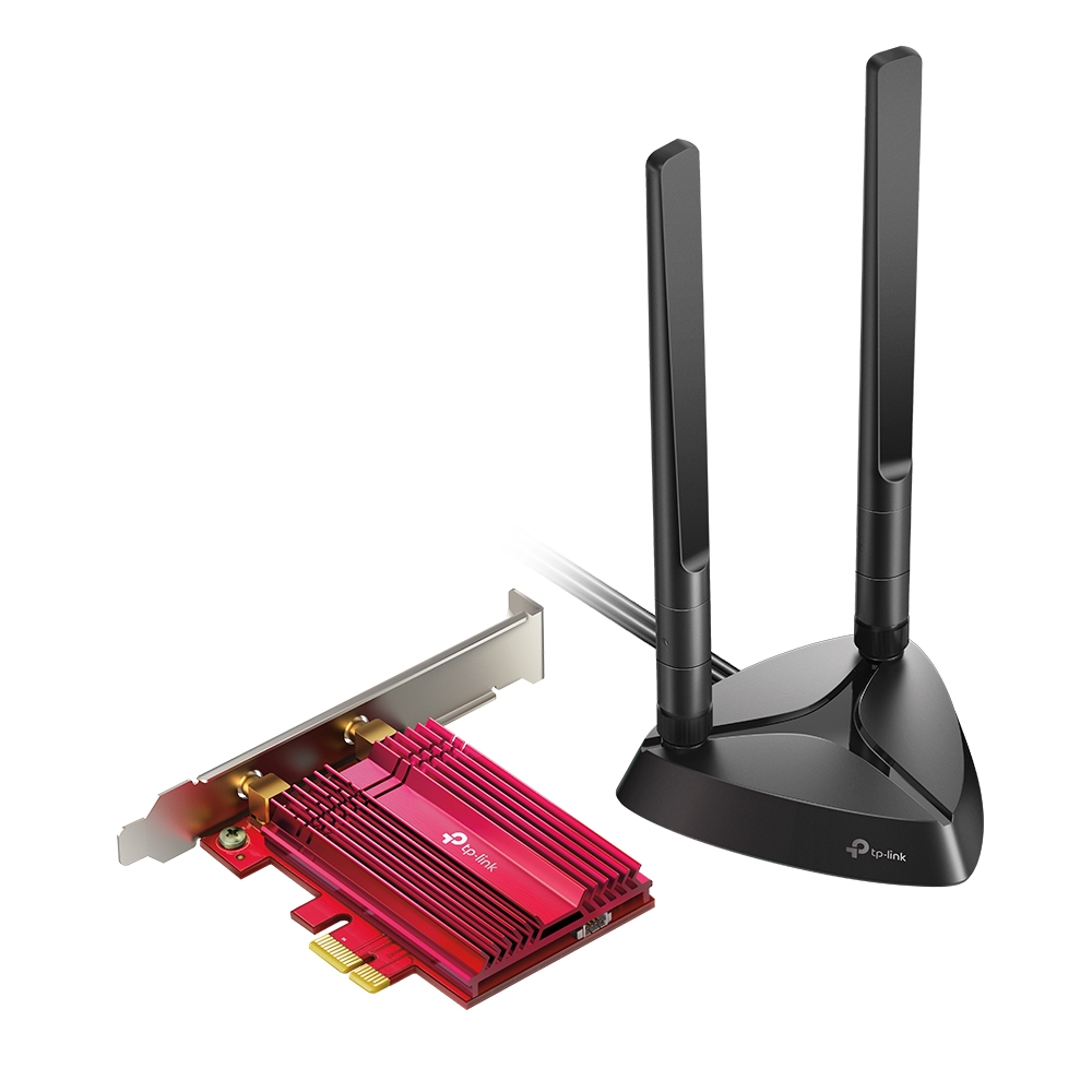

What client device and WiFi card are you using?

Client device is a custom-built gaming PC running Windows 10, with an Archer TX3000E wifi card.

I don't know the TX3000E, but it does seem suspect to me (in addition to it's location directly beneath the router).
The RT-AC56U was an excellent Media Bridge router (many still in use for many customers). Today though, they are hard to find. Any 3x3:3 (or better, a 4x4:4) router with Media Bridge capabilities will far surpass the Archer you're currently using.
