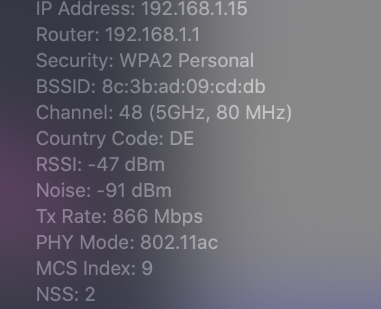

Guys,
my wireless performance on RBK50 driving me crazy. Voxel FW didn't improve it in my case.
Speedtest on orbi itself shows stable 850 mbps download, 913 mbps upload.
No matter how close I'm to router, using macbook pro 2018, iphone XS, i can't achieve speeds higher than 250-350 mbps download, 400-450 mbps upload.
On same devices using one of nighthawk (can't remember specific model) - speed was wayyyyy higher.
My channels not really congested, so i have no idea what's possible cause.
Any ideas ?
Guys,
Any ideas ?
Try switching channels?
You'll not see much over 400-500Mpbs on the down on orbi. Your connection rate is already 866 which is max for a connection rate, this is only a connection rate. Actual speed thruput differs and will be slower based on device design and support there.
I presume your wired speeds are to spec since wired LAN supports 1000Mpbs connection rate. You should see near 900Mpbs on the down here.
Guys,
Any ideas ?
Ya, all we can do is ask or request. Voxel is receptive to requests and if it's in his means and can take the time, he usually gets it done. Just have be patient. Voxel does great work for those NG products he likes working on. ;)
That will be great, but given that he is doing it as a hobby, for free, and in his spare time one can not demand anything. If it happens I will be glad, and if it doesn't happen I am just so happy that my Orbi works superb now and I didn't lose my money, I learned through life that we have to give the blind eye to some things and if that is going to be the extra steps(like you mentioned) to reset the router, so be it!
To add ... sure make the request to Voxel ... but if you are on a timeline for a specific feature ... you might want to consider a purchased product with the feature(s) you desire.
Does it serve 400-500Mbps per device or total output? I mean if I connect a computer and iphone, can I get 400Mbps on each, or will they share the 400Mbps?
Shared, if on the same node. :)
Guys,
Any ideas ?
How much higher? A web search shows that max AC speed is 400-500Mbps. Maybe you were using a Wifi 6 router? I have Tx Rate : 300Mbps I am pretty close to the router.
You'll not see much over 400-500Mpbs on the down on orbi. Your connection rate is already 866 which is max for a connection rate, .
shouldn't he get more if he uses Mu-Mimo? My understanding is that 400Mbps is typical AC speed of a single antenna, but with Mu-Mimo using double antennas will give you double the speed?! Maybe I am understanding this wrong.
Some but not much. Maybe 600Mpbs. Again, depends on device support and design.
