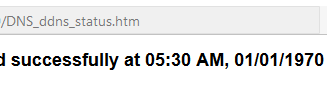

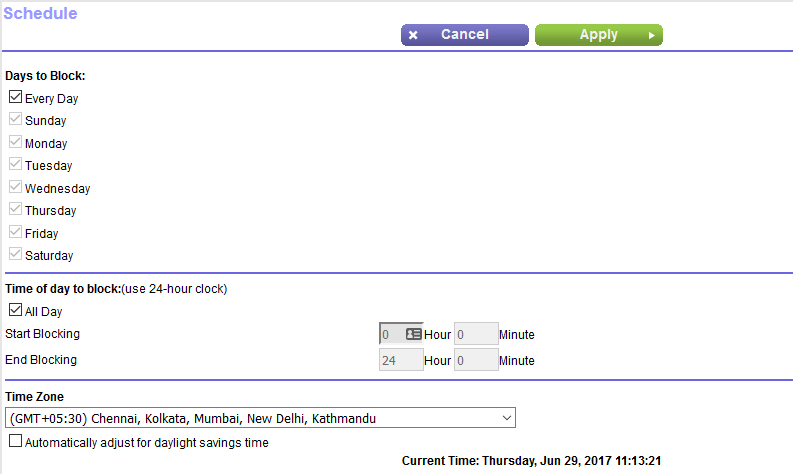

Hi Voxel,
I would like to report that DDNS at times wont work. Manually need to go to the status button for sometimes or disable and enable it for it to work again
Also the date is wiered.
