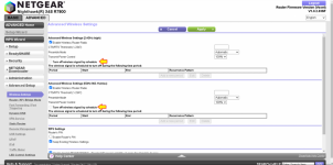

No i never lose the radio after update, its only that i cant enter the settings as in the photo anymore.
I tried all the resets its still the same, cant enter in any mode.
Before the update all settings worked and i could enter them all.

I also can not enter into the Schedule settings as well?

There are nvram values to enable/disable this schedule from telnet/ssh:
to enable:
nvram set wladv_schedule_enable=1
nvram set wladv_schedule_enable_a=1
nvram commit
to disable:
nvram commit
and try to check what is in your nvram with schedules:
nvram show | grep sched

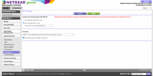

I also have problems to set NTP server for time, and it has internet connection but still does not work?
And the NTP settings are the same as on my gateway (ntp1.rgw.telia.se, ntp2.rgw.telia.se)
I notice that is shows time BUT its 1h behind, but stills get the message:
Warning:The router has failed to connect to the selected NTP server,please check your internet connectivity or try another NTP server

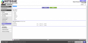

And what is this block schedule, block what?
And i cant enter the setting in here as well?
pege63
This is to block access to the internet on certain times.
And in the screenshot, apparently you blocked all days from 00:00 to 24:00, so you blocked internet access always.
This would also explain why it cannot connect to NTP or reach cloudfare...
Yes, BUT the thing is hat i have Internet access on both LAN & WIFI and all clients can connect to the router and they all have internet access.
Must be a way to upload a "empty" *.cfg file to the router, where this is not ticked in NTP & schedule.
Or is there a code to delete the schedule settings?
But on the other side the commands from a router shell/prompt to Erase all configuration data did not worked at all, everything was still there after reboot.
