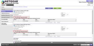

To me it looks like you are ap or repeater mode i dont think it wise to turn off or system allows by default on that mode.
I am in AP mode i was not like this on the FW before i updated, i dont turn off anything.

Unfortunately it's a common problem to lose radio when updating firmware. Netgear/Voxel same issue.
Ever tried the kamoj add-on, and it's wifi supervision?
Or try this from a command prompt:
   wlan down;wlan up;for i in 1 2;do { [ "$(dni_wlan radio 11a -s)" != "ON" ] || [ "$(dni_wlan radio 11g -s)" != "ON" ]; } && wlan toggle; done
If not helping read the kamoj FAQ.txt and to the "better factory reset" described there.
