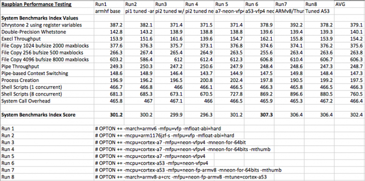

Spent some time this afternoon with gcc.... interesting results between armv6/v7/v8 code on A53 - I do reference numbers here - these are all single threaded benchmarks on a53
The cafeole board - just consider that Marvell is a bit faster on the memory side...

FYI... @Voxel - as per earlier discussions - one can over optimize.. compiler options might do good things to some parts, but generally...
Interesting... Version of GCC is 4.9.x?
