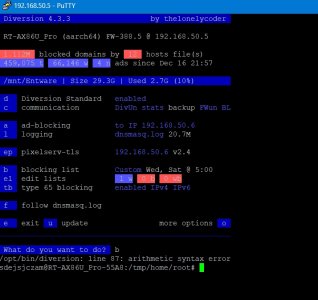

I was attempting to add a new block list to Diversion but every time I press the B on my keyboard I get this error: /opt/bin/diversion: line 87: arithmetic syntax error.
I tried to uninstall Diversion so I could reinstall it but I get the same error message.
Does anyone have any idea on how to proceed from here? I would like the Diversion menus working correctly again.

Enter 1233 into Diversion, see if that fixes it.
I don’t know if I tried that specific code, the 1233 but I went to your Diversion website and tried all the code’s listed and was still getting that error message:
Luckily for me it turned out I just had to reboot the router and SSH into the router again and retry. After the router reboot everything works perfect again.
Yep definitely sounds like you were due for a reboot.
