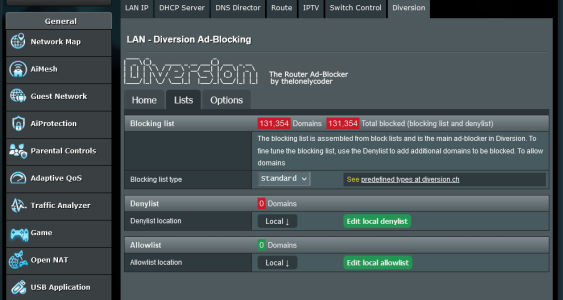

https://www.freedommobile.ca/en-CA and https://login.freedommobile.ca/ both are not working properly (not clickable) when Diversion "Ad-Blocking) is on.

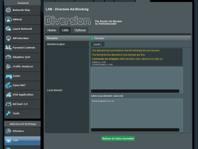

How do I add them to bypass Diversion? I tried adding freedommobile.ca to Router - LAN - Diversion - Lists - Edit local allowed list and even restarted my router but both sites are still not working properly.
What am I doing wrong?
Thanks.

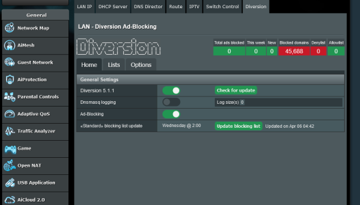

Guess what, all of a sudden its working fine now, all clickable.
I changed the Blocking list type from Standard to Small to Minimum and back to Standard, and somehow now the Blocking list Domains went from 131,354 (previous "Standard") to only 45,720 also in Standard!
Previous Standard Blocking list Domains corrupted? How many Blocking list Domains is in your "Standard"?
Old vs New
OLD Standard Screenshot 2024-04-06 at 02-05-02 LAN - Diversion Ad-Blocking.png
OLD Standard Screenshot 2024-04-06 at 02-06-14 LAN - Diversion Ad-Blocking.png
New Standard Screenshot 2024-04-06 at 05-14-13 LAN - Diversion Ad-Blocking.png
New Standard Screenshot 2024-04-06 at 05-14-26 LAN - Diversion Ad-Blocking.png
45,688 on the Standard list here, nearly 240,000 with the Large list.

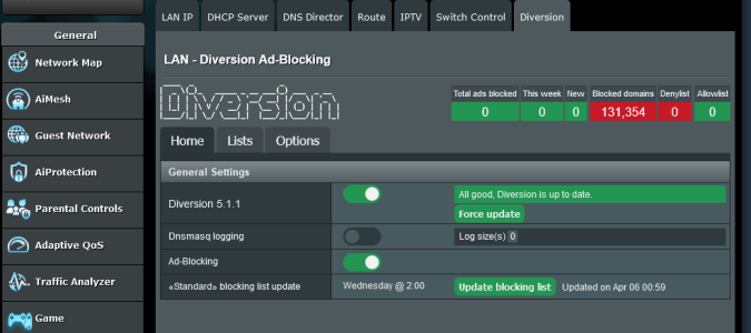

Strange thing, your Diversion shows no ads or domains blocked. Have you reset it?
What version of Diversion are you running?
5.1.1
Yes, mine is not blocking any ads now, what did I do wrong?
If you haven't reinstalled then either a setting is wrong, configuration is corrupt, or the install is corrupt.
