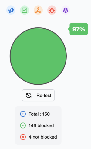

I get 97% with Diversion+ Hagezi's Pro ++ list + Ublock Origin
