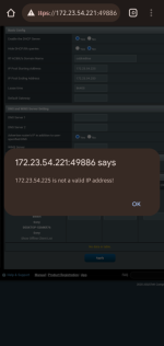

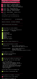

Um having issue on install of diversion. Pic below. Side note, don't know if issue with GUI for dhcp it keeps telling me that an address is invalid when configuring the start and end addresses. This occurs even after hard resets. So I changed them over ssh, nvram set. Using 172.23.0.0/16. Router model: rt-ac88u, merlin firmware version 386.5_2.
What is your Subnet Mask in LAN -> LAN IP page?
