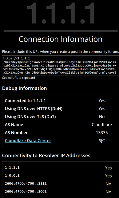

Latest version 2.0.17 finally "officially" passes Cloudflare's debug test!

DNSSEC protection is enabled, but no, not strict validation. DNSSEC tests are positive though, given the "ad" flag:
I tested with stubby dot too. Cloudflare cannot use strict dnssec if not the cloudflare test will fail.
