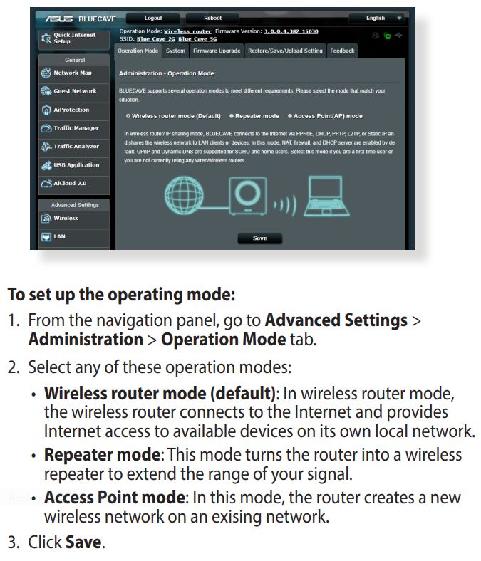

According to the specs on the Asus website it does, but looking at the user manual (p86), there's no mention of this:
Can someone clear this up please?
(thinking of buying this to use as a wireless bridge, aka media bridge mode)

Unless the firmware changed and added Media Bridge Mode (if I can see that blurry image good enough, it looks like firmware v382.xx), it doesn't.
Don't you have any other choices, other than a Blue Cave?
If you own that BlueCave I suggest to make sure it runs the latest firmware (3.0.0.4.384.46630) and have a look at the real Operation Mode page to see the actual supported modes.
With the latest firmware it does support AiMesh, which offers similar functionality like Media Bridge (given that your main router does support AiMesh).

Anyway if the Aimesh feature is now included in the latest firmware on the Blue Cave so I'm guessing Mediabridge will also be included. It seems my screenshot is of an earlier or initial firmware for the Blue Cave where Mediabridge wasn't included.
Media Bridge mode isn't the same as AiMesh. In Media Bridge mode, the router only supports wired clients. In AiMesh mode, it supports both, but with the disadvantage of having another AP 'dirtying' up the airwaves with needless Wi-Fi. How are you going to ensure nothing connects to it wirelessly? If anything does, and while it is active, your throughput is cut in half.
Asus adding AiMesh does not automatically mean it would add Media Bridge mode too.

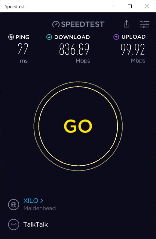

An update: bought the Blue Cave last week and its working flawlessly in media bridge mode. I did a wired speed test on my laptop connected to the Blue Cave in the location where the Blue Cave will live and its giving me 800+ Mbps consistently - previously i couldn't get above 600 Mbps on my Netgear R6300v2. So it seems that extra send/receive stream on the Blue cave (4x4 versus 3x3) gives me an extra 200 Mbps or so in throughput. Happy days!
This is exactly the reason to want a full-fat 4x4:4 router and AiMesh nodes/Media Bridges (always).
