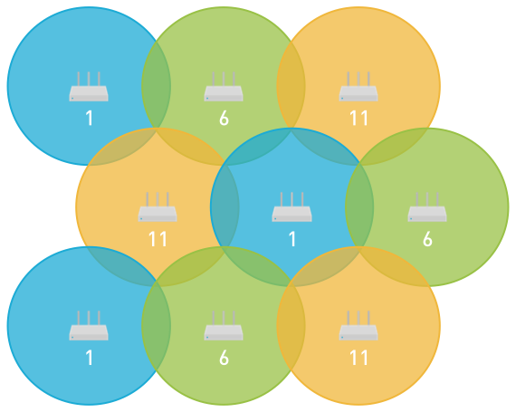

I live in a apartment complex and wath i did was i talked to all of my neighbors and build up a plan for better WIFI in our homes, and this is wath we did and everybody is happy
Howdy,
Your missing what is being said.
You should be using channel 1 or 6 or 11 for the 2.4Ghz band
Yes, use the 20Mhz wide only for better stability
Anytime you are splitting channels, you can get interference from both sides. What you want to do is use something like insider on a laptop, or Wifi Analyzer on your smart phone to only see what main channel (1,6,11) has the least amount of wifi usage and signal strength .
Remember, splitting channels is not good.
Concur - 1, 6, 11 with narrows channels is best for 2.4GHz - and camping in between not only impacts own WLAN, it impacts everyone nearby...
