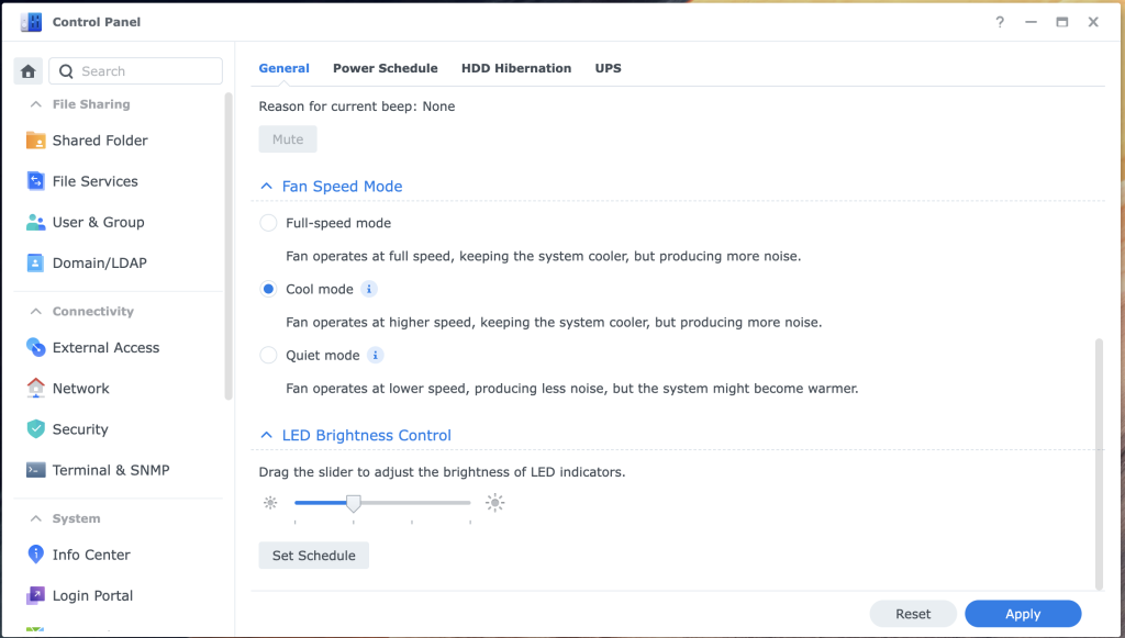

Check your fan settings... default is "cool mode" which keeps the fans spinning...

So... I replaced the fans with top notch Noctua 's NF-A9 FLX "premium fans". Expensive stuff for fans. Didn't get anywhere. Noise levels seem about the same as stock fans. Sure I could use the RPM reducing cables that are provided with the Noctuas (which lower RPM from 1600 to either 1250 or 1050), but then airflow tanks below acceptable levels.
