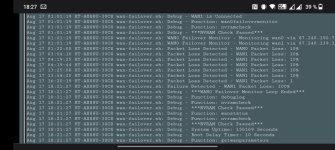

What means 1 in the log? Is it really 1 or is it a typo, Just everywhere as a percentage.
Aug 17 16:20:19 RT-AX88U-30C8 wan-failover.sh: Packet Loss Detected - WAN1 Packet Loss: 1
Not sure how that happened but my guess is this. The output of the pings are written to a temporary file in memory under /tmp and the function is set to wait on the ping commands to finish before reading the output but somehow the write may have not been finished when it was being read.

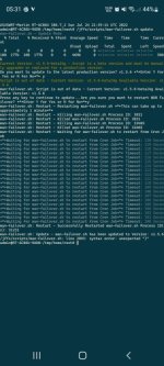

Error during update:

No it should be there just grabbing it a different way to ensure accuracy, do you have logs you can send?

WAN0 and WAN1 can be specified to have QoS Enabled or Disabled during Failovers.
Thanks and slapped this beta in for testing, specifically for this feature.
Observation
- QoS is only disabled on Failover and not reconfig/restart of the script. My expectation is that on reconfig/restart the QoS settings/toggle should be enabled/disabled based on configuration file. Thus, for WAN0 I had to manually disable QoS. Trending in the right direction as usual @Ranger802004
