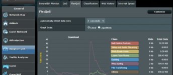

After installing FlexQoS 1.2.3 via the GUI and rebooting the router AC86U, The FlexQoS Tab has indeed moved, though I am missing the version number (1.2.3) on the GUI and don't currently have the command button to check for update:
BIG EDIT:
Nevermind, I see that the feature to see version number and update has been moved to a sub-menu..... Sorry!
- Moved version number and update check under Options panel
Your GUI is getting fancier and fancier! Pretty soon it will be able to do all our Taxes too, without a doubt! :cool:
